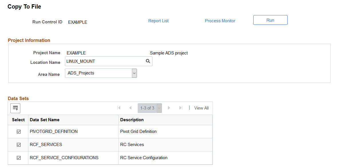

  4. Select the file location and area to copy the file.
  5. By default all data sets in the project are selected.
  6. Click the Run button.

This example illustrates the fields and controls on the Copy To File page.
Copy To File page
If dataset instances are missing from source database, copying to file will continue for the rest of the ADS objects and a warning message will be issued for the missing objects. To view the message, open the message log in the Process Monitor page.
