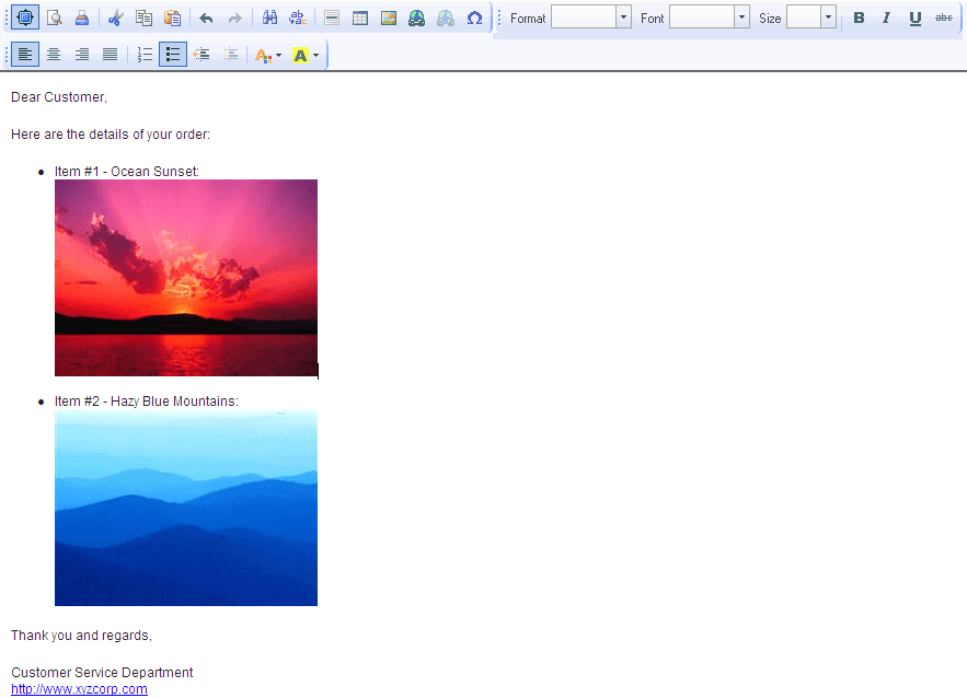

For example, the rich text editor is used to create a message containing text and two images as shown in this example:
This example illustrates the fields and controls on the Rich text editor displaying an example email. You can find definitions for the fields and controls later on this page.
The HTML for this email is as follows:

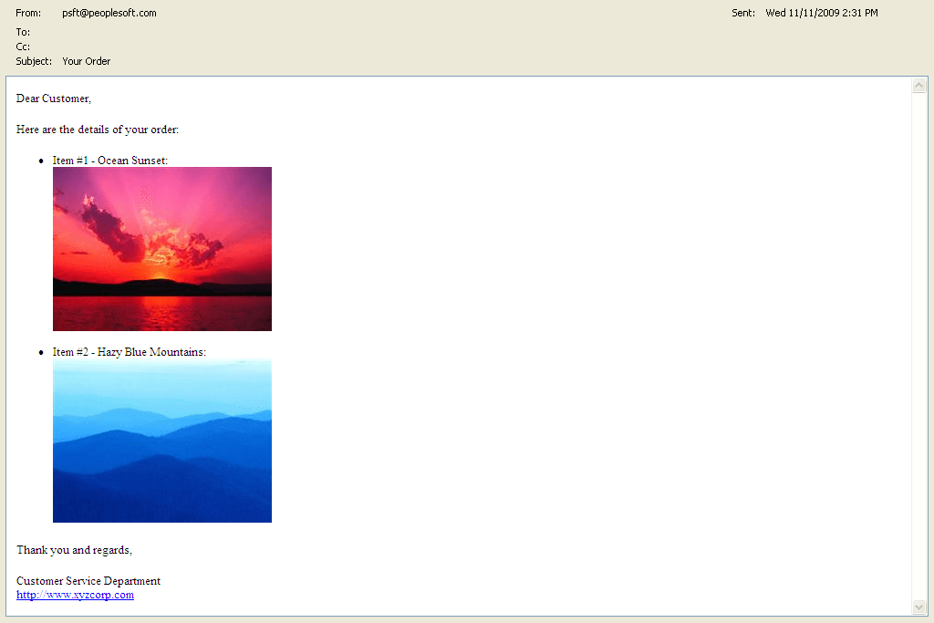

Observe that the email received by the recipient is formatted the way that it appeared in the rich text editor as shown in the following example:
This example illustrates the fields and controls on the Email as received in Microsoft Outlook. You can find definitions for the fields and controls later on this page.
Finally, the XML code that represents this email message is as follows:
