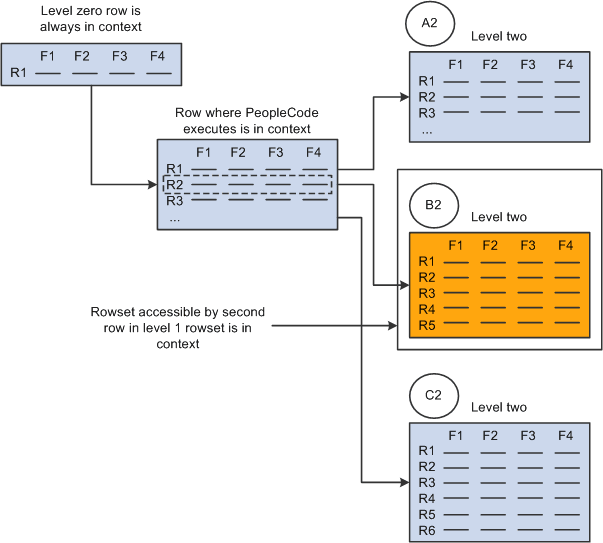

Most PeopleCode programs run in a current context. The current context determines which buffer fields can be contextually referenced from PeopleCode, and which row of data is the current row on each scroll level at the time a PeopleCode program is running.
The current context for the data buffer access classes is similar to the current context for accessing the component buffer, as shown in the following diagram:
In this example, a PeopleCode program is running in a buffer field on the second row of the level one rowset. The following code returns a row object for the second row of the level one rowset, because that is the row that is the current context.
Local Row &ROW&ROW = GetRow();The following code returns the B2 level two rowset because of the current context:
Local Rowset &ROWSET2&ROWSET2 = &ROW.GetRowset(SCROLL.EMPL_CHKLST_ITM);This code does not return either the C2 or the A2 rowsets. It returns only the rowset associated with the second row of the level one rowset.
