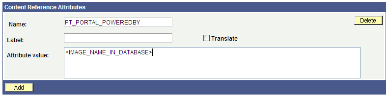

This example illustrates building portal homepage tabs using fixed-name HTML and image definitions.
Content Reference Attributes region of the Content Ref Administration page
To override a default fixed-name HTML or image definition:
  1. In the Content Reference group box at the bottom of the page, click the Edit link for a content reference.
  2. Scroll to the Content Reference Attributes group box for a content reference.
  3. In the Name field, enter the name of the default definition that you want to change.
  4. Deselect the Translate check box.
    You must deselect the Translate check box for the override to be successful.
  5. In the Attribute Value field, specify the new definition value.
    The value that you specify can consist of letters, digits, and underscores ( _ ). It cannot contain any spaces and cannot begin with a digit.
  6. Click Save.
You can omit the Label field value.
As shown in the example, to replace the Powered by PeopleSoft image on the homepage tab, add a untranslated attribute named PT_PORTAL_POWEREDBY with a new image definition name in the database.
