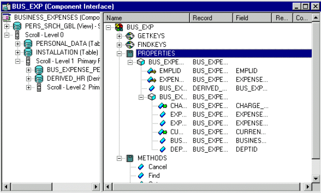

The BUSINESS_EXP component definition appears in the left frame in the following example. The properties and methods that are exposed through this interface are displayed in the right frame.
Component interface definition

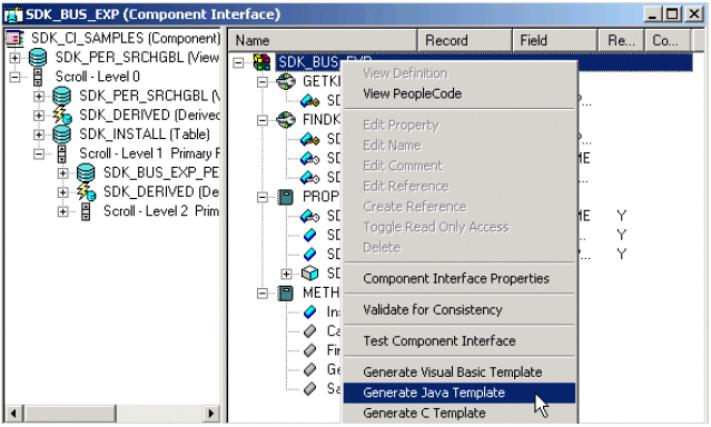

After the component interface definition is saved, you can then generate the Java classes for invoking this interface. You do this using the Generate Java Template command in PeopleSoft Application Designer: This example illustrates generating the Java classes for the SDK_BUS_EXP component interface.
Component interface - Generate Java Template
