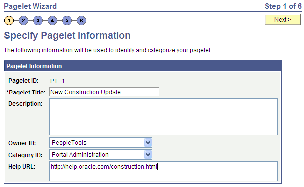

This example illustrates the fields and controls on the Specify Pagelet Information page. You can find definitions for the fields and controls later on this page.
Field or Control Description
Pagelet ID
Enter an ID for the pagelet. Each pagelet that you build with Pagelet Wizard must have a unique ID.

Pagelet Title
Enter a unique title for the pagelet. This value appears in the pagelet title bar, which is the solid bar at the top of the pagelet. If you change the pagelet title value for a published pagelet, you must unpublish and republish the pagelet for the change to take effect.
Description
Enter additional descriptive information to identify the pagelet.
Owner ID
Select the value that you want to use to identify pagelets created by the organization. The portal administrator can use this value when searching for pagelets through PeopleSoft Application Designer or SQL queries on the portal registry table.
Do not select a delivered PeopleSoft owner ID. You can define unique owner IDs for the organization by entering field translate values for the OBJECTOWNERID field using PeopleSoft Application Designer.
Category ID
To organize Pagelet Wizard pagelets, select a category assignment for the pagelet. You create pagelet categories on the Define Categories page. The portal administrator can use this value when running pagelet reports and when searching for pagelets that need to be moved between different portal sites.
Categories provide another level of organization in addition to the owner ID. For example, you can use a departmental owner ID, and within that, categorize pagelets for that ID by pagelet type.
See Defining Pagelet Wizard Pagelet Categories.
Help URL
Enter the URL of the help document to associate with the pagelet. Entering a URL causes the Help button to appear in the pagelet header bar.
When the pagelet is published as a homepage pagelet, a PTPPB_PAGELET_HELP_LINK content reference attribute is added to the pagelet content reference definition corresponding to the pagelet. The value of this content reference attribute will be the help URL entered by the user.
Note: The Help button appears only when the pagelet is on the homepage inside the PeopleSoft Portal; it does not appear when the pagelet is displayed as a WSRP portlet.
Note: The pagelet help URL takes precedence over the help ID, when both attributes are set for a pagelet.
