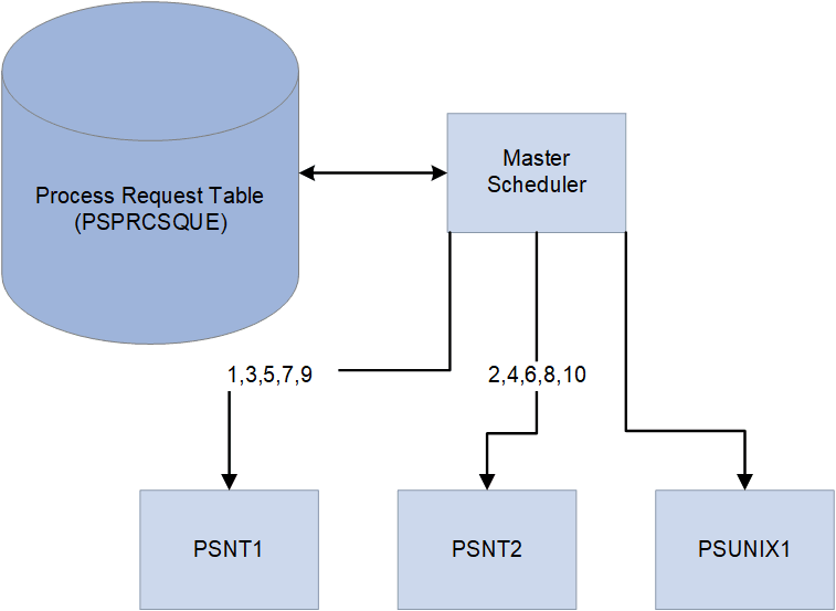

The Load Balancing Option affects how Master Scheduler performs the round-robin assignment for all available remote servers in attempting to load balance the workload. When the option Assign to Primary O/S Only is selected, Master Scheduler performs a round robin only to all remote servers that are booted in the primary O/S.
This diagram illustrates the setup of a master scheduler using load balancing option that is assigned to primary O/S
Example of Master Scheduler setup using the Load Balancing - Assign to Primary O/S Only option
In this case, the Primary Operating System is Microsoft Windows. This is the operating system in which both PSNT1 and PSNT2 are initiated. When Master Scheduler finds new queued requests with blank server names, the workload is evenly distributed between the two Windows Process Scheduler servers only. Although PSUNIX1 is available, no requests are assigned to it . The remote server PSUNIX1 is assigned only with new requests that are scheduled with this specific server name.

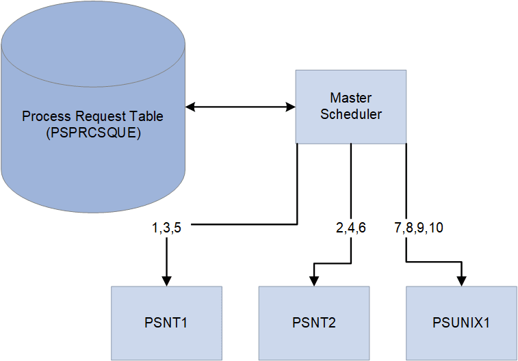

If the option is set to Assign To Server In Any O/S, Master Scheduler attempts to load balance workload to all active servers. At first, it tries to distribute work to servers residing in the primary operating systems. When it has reached the server definition limitations, it attempts to route work to the remaining active servers. For example, Master Scheduler will round robin the prioritized lists to both PSNT1 and PSNT2, as these servers are booted in the primary operating system. Assuming the Max API Aware for both PSNT1 and PSNT2 is three, then the first six process requests will be distributed between PSNT1 and PSNT2, and the reaming requests will be distributed to PSUNIX1 .
The pattern for how Master Scheduler assigns requests to available servers with this option is illustrated in this diagram:
This diagram illustrates how Master Scheduler assigns requests to available servers
Example of Master Scheduler setup using the Load Balancing - Assign To Server In Any O/S option
