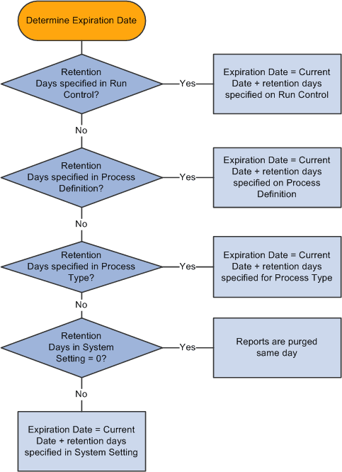

Report Retention Days
The expiration date for a report is determined by adding the reports retention days to the date the report was run. Retention days for a report can be set at various levels. The system determines the retention days for the report at runtime in the order:
  1. Run Control record
  2. Process definition
  3. Process Type definition
  4. System Setting
This diagram illustrates the precedence for determining the number of retention days for the report
Expiration date determination
