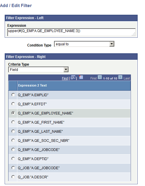

    This example illustrates the Add/Edit Filter page displaying the Filter Expression – Left section (the left operand) and the Filter Expression – Right section when you add a filter for an expression field.
    Add / Edit Filter page - expression filter
  5. Click the OK button to accept the changes and return to the Composite Query Manager page.
    The newly added filter is listed in the Composite Query Manager page on the Filters tab.
