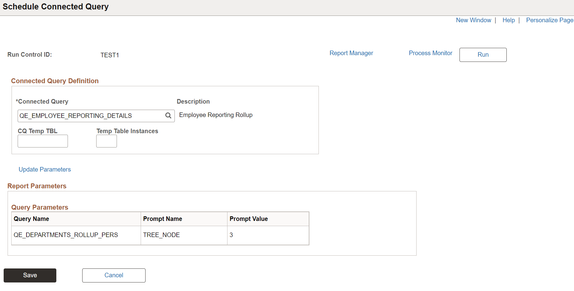

This example illustrates the fields and controls on the Schedule Connected Query page. Definitions for the fields and controls appear following the example.
Field or Control Description
Report Manager
Click to access the Report Manager page to view the report content after the output file is posted and the output destination is set to Web or Window.
The final output file is posted to the Report Manager repository for web access by authorized users.
See Process Scheduler: Administering Report Manager.
Process Monitor
Click to access the Process Monitor page and check the progress of your request.
See Process Scheduler: Understanding Process Monitor, Process Scheduler: Viewing the Status of Processes.
Update Parameters
Click to update the runtime prompt values of connected query.
See Process Scheduler: Submitting Process Requests.
Run
Click to access the Process Scheduler Request page, where you can specify variables, such as where a process runs and in what format the process output is generated. The values for output type and output format appear by default per the report definition and can be changed if the report definition allows it.
Note: The Run button in the Schedule Connected Query page functions as the Schedule link in the Connected Query Manager search page.
Connected Query
Enter or search for a connected query.
Note: On the Schedule Connected Query page, you cannot modify the connected query name after you save the Run Control ID.
CQ Temp TBL
Enter the name of temporary table.
This value indicates whether the search definition uses the connected query as its data source.
Temp Table Instances
Enter the temporary table instance.
