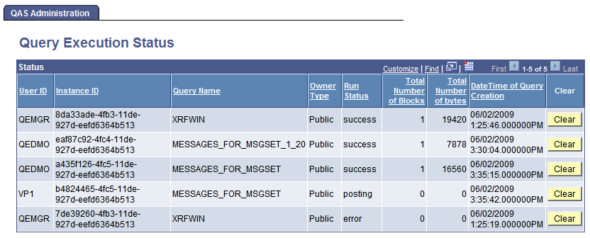

This example illustrates the fields and controls on the QAS Administration page.
This page displays the run status for QAS service operations that execute queries on the PeopleSoft system. Depending on the execution type and output format, you will see various run statuses.
This table lists the run statuses by output format.
Output Format Status Description
FILE
running
The report is running in Process Scheduler.
FILE
posting
The report was posted to the report repository.
FILE or NONFILE
error
The query encountered an error. If the query does not exist or the user does not have access to the query, an error will occur.
NONFILE
success
The query data is stored in the Integration Broker runtime tables.
Use the Clear button to delete entries from the page.
