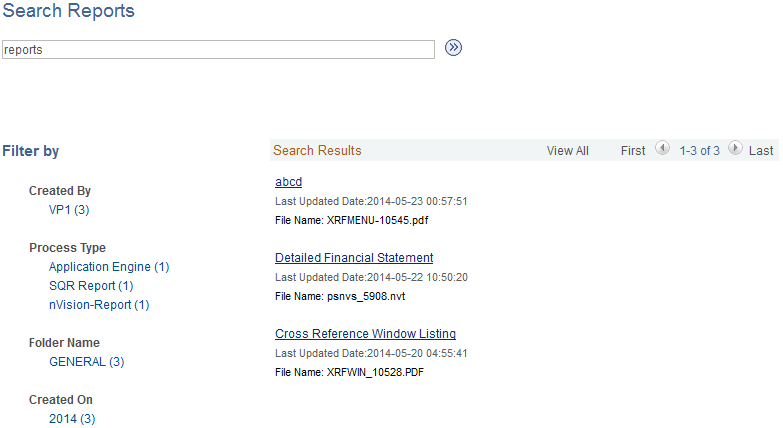

The following example provides a sample search using the Search Reports page. Descriptions of the controls follow the example.
Search Report page
The default facets by which users can filter the reports are:
  • Created By: Filters results by the user ID submitting the report.
  • Process Type: Filters results by process type (SQR, Application Engine, and so on).
  • Folder Name: Filters results by the folder name where the report resides in the report repository.
  • Created On: Filters results by date.
