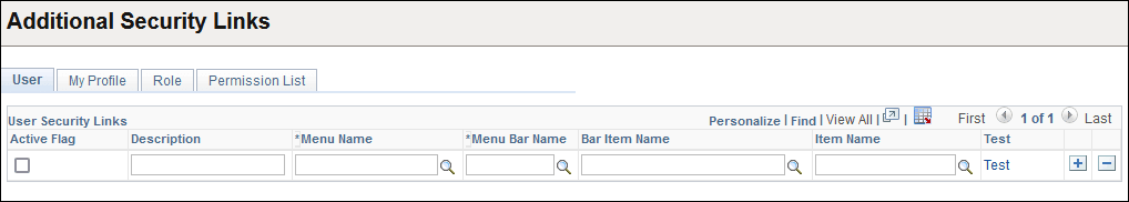

This example illustrates the fields and controls on the Additional Security Links - User page.
Field or Control Description
Active Flag
Enables you to activate and deactivate links. Only those links with the Active Flag selected appear for system users.
Description
Add a description of the page that contains the extra security information. This description is the text that appears on the Links page for the security profile.
Menu Name
From the drop-down list, add the menu name. This value is the application in which the page resides, such as Administer HR Security.
Menu Bar Name
From the drop-down list, add the menu bar name, such as Use, Setup, Process, and so on.
Bar Item Name
From the drop-down list, add the bar item name. For example, the bar item name for this page is Security Links.
Item Name
From the drop-down list, add the item name. For example, the item names for this component are User, Role, My Profile, and Permission List.
Test
After you have added all the appropriate information, use this link to test the security link. If it does not work correctly, double-check your selections for the previous options.
