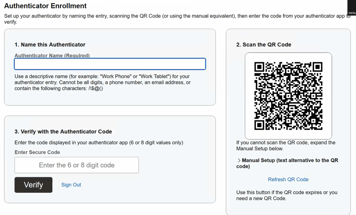

  2. Click Add New Authenticator.Authenticator Enrollment page
  3. On the Authenticator Enrollment page, enter a name in the Name this Authenticator field.
    Enter a descriptive name, and ensure that it meets the following requirements:
    • It cannot be all digits.
    • It cannot be a phone number.
    • It cannot be an email address
    • It cannot include any of these characters: forward slash (/), back slash (\), dollar sign ($), at sign (@), left and right parentheses (()).
  4. Use your device to scan the QR code on the page.
    If you cannot scan the code, expand the section Manual Setup (text alternative to the QR code) below the code. The section includes a URL that you enter in the authentication app on your device.
    If you need a new QR code, for example if it expires before you enter the one-time code, select Refresh QR Code.
    The number of digits and the time before a code expires are set by the administrator.
  5. Go to the authentication app on your outside device to find the generated one-time code.
  6. Return to the Authentication Enrollment page and enter the code in the section Verify with the Authenticator Code.
  7. Click Verify.
    A card with the authenticator entry appears on the page.
