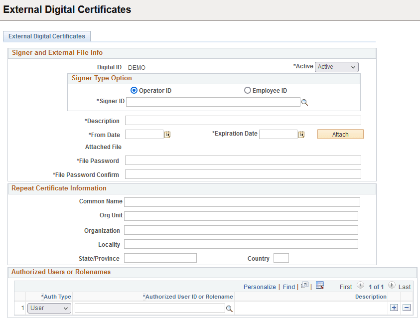

This example illustrates the fields and controls on the External Digital Certificates page. You can find definitions for the fields and controls later on this page.
Use the Signer and External File Info section of the page to define the certificate signer, upload the PFX certificate to the database keystore, and define the validity dates for the certificate. This table describes the fields and controls in the Signer and External File Info section of the page.
Field or Control Description
Digital ID
Displays the digital ID for the certificate.
Active
Use the field to activate or deactivate the certificate. The valid values are:
  • Active. (Default.) Activate the certificate.
  • Inactive. Deactivate the certificate.
Operator ID
Click the radio button to specify the certificate signer (in the Signer ID field) by user ID.
Employee ID
Click the radio button to specify the certificate signer (in the Signer ID field) by employee ID.
Signer ID
Click the Lookup button to select the certificate signer.
The values that appear for selection depend on whether you’ve selected Operator ID or Employee ID as the signer type.
Description
Enter a description for the certificate.
From Date
Enter the beginning validity date for the certificate.
Expiration Date
Enter the expiration date for the certificate.
Attach
Click the button to attach the PFX certificate file. The file should include the certificate and its password.
File Password
Enter the PFX certificate password.
File Password Confirm
Enter the PFX certificate password again.
This table describes the fields and controls in the Repeat Certificate Information section of the page.
These are standard signature attributes that define the owner and details of the signature file as required by a certificate authority, audits, and reporting as required by local regulatory systems.
Common Name
Enter the common name defined in the attached PFX certificate.
Org Unit
Enter the organizational unit defined in the attached PFX certificate.
Organization
Enter the organization defined in the attached PFX certificate.
Locality
Enter the locality defined in the attached PFX certificate.
State/Province
Enter the state/province defined in the attached PFX certificate.
Country
Enter the country defined in the attached PFX certificate.
Use the Authorized Users or Rolenames section of the page to define the users and roles that can apply the digital signature to PDF report output. This table describes the fields and controls in the Authorized Users or Rolenames section of the page.
Auth Type
Choose the authorization type from the drop-down list. The valid values are:
  • Role.
  • User. (Default.)
Authorized User ID or Rolename
Click the Lookup button to select the ID. The values that appear for selection defined on the authorization type selected.
Click the Add Row button (+) to add additional users and roles that can apply the digital signature.
