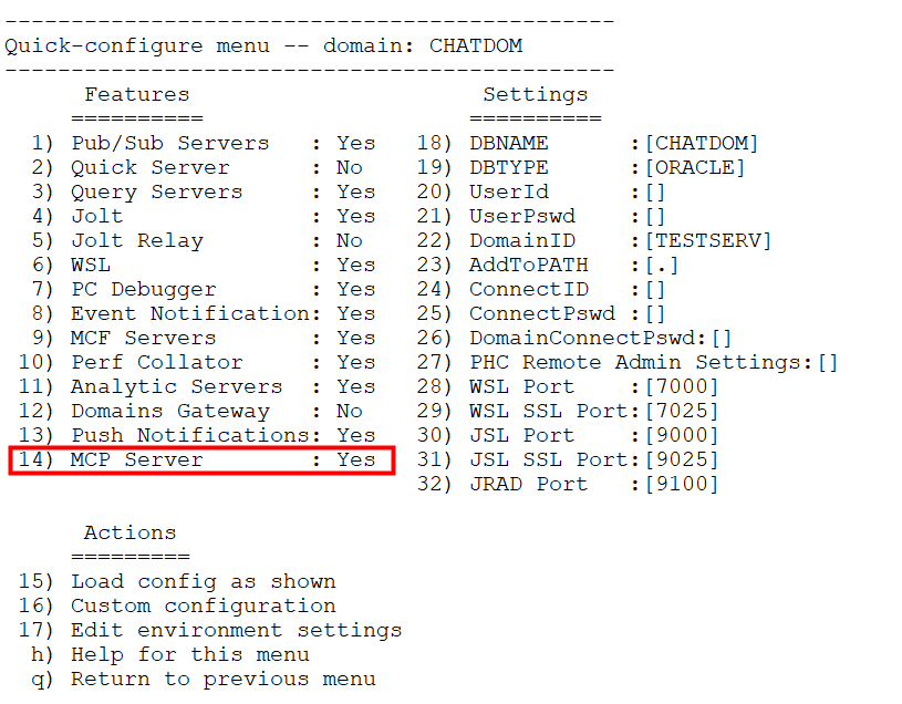

  2. Enable the MCP Server feature for the Chat UI within the application server domain settings. This feature is disabled by default.
    The following image illustrates the MCP Server feature for the Chat UI in the application server domain.
    MCP Server feature in Application Server Domain
    Enter Yes to enable the MCP Server feature for the Chat UI.
    Enable the MCP Server feature for the Chat UI on only a single application server domain.
    The MCP Server feature for the Chat UI is only available for Linux application server domains.
