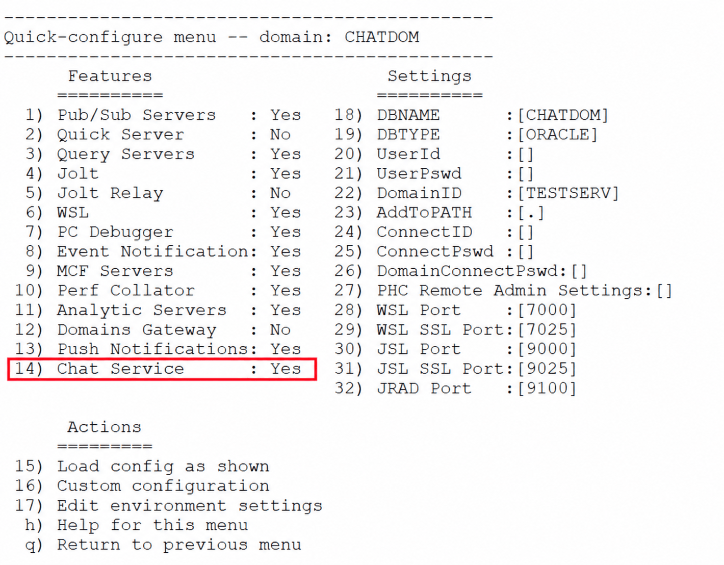

  2. Enable the Chat Service option within the application server domain settings. This option is disabled by default.
    The following image illustrates the Chat Service option in the application server domain.
    Chat Service feature in Application Server Domain
    Enter Yes to enable the Chat Service option.
    Enable the Chat Service option on only a single application server domain.
    The Chat Service option is only available for Linux application server domains.
