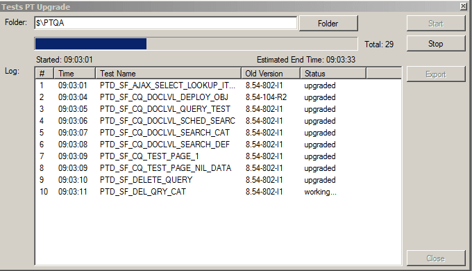

Log
This grid is populated as tests are upgraded. It lists each test that is updated, the time it was updated, the version it was updated from, and its upgrade status.
Export
Click to save the test upgrade log to a text file.
This action is available only after all tests are upgraded, or when the upgrade process has been stopped.
This example shows the Tests PT Upgrade dialog box during the upgrade process.
Tests PT Upgrade dialog box - processing
