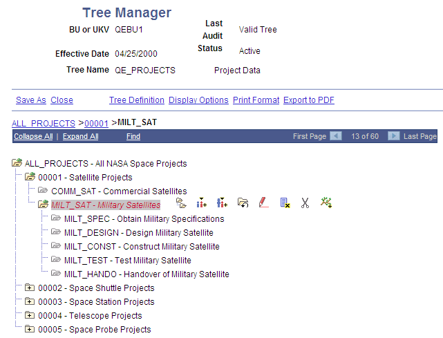

This example illustrates a tree with levels.
Example of a tree with levels
