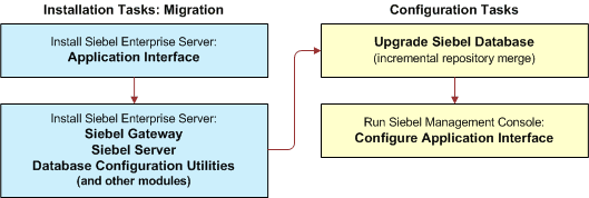

The following figure presents a simplified view of the installation and configuration tasks for Siebel CRM server modules for a migration deployment, which are as follows:
  1. Installation Tasks: Migration. Install Siebel Enterprise Server and the following components: Siebel Application Interface, Siebel Gateway, Siebel Server, Database Configuration Utilities (and other modules).
  2. Configuration Tasks. Upgrade Siebel Database (incremental repository merge). Run Siebel Management Console and Siebel Application Interface.
Note: This illustration does not mention installation or configuration tasks for security or the Siebel Migration application. However, those tasks, where applicable, are implicitly part of this roadmap.
Installing and Configuring Siebel CRM for a Migration Deployment: This image is described in the surrounding text.
