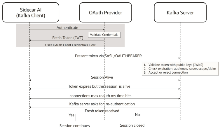

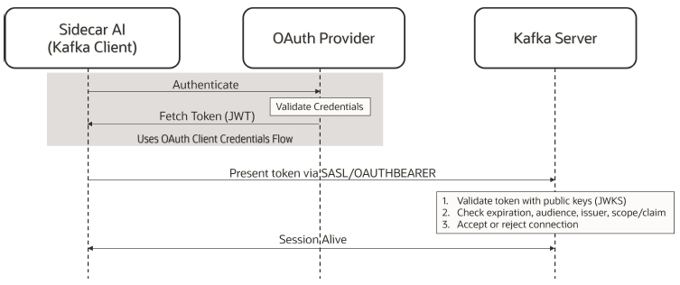

Configuring SASL/OAUTHBEARER
In an Event Publication and Subscription setup, SASL/OAUTHBEARER is used to ensure secure and protected data exchange between Siebel CRM and Kafka. It enables Kafka clients (producers and consumers running in the sidecar AI) and brokers to authenticate with Kafka brokers using secure tokens issued by an OAuth 2.0 authorization server, such as Oracle IDCS, and so on.
A sample information exchange flow for SASL/OAUTHBEARER authentication is shown in the following diagram.
This image shows the information exchange flow for SASL / OAUTHBEARER authentication
In this case, when a producer (Kafka client) running in the Sidecar AI wants to publish messages to Kafka, the following happens:
  1. The producer fetches a token from the OAuth 2.0 server.
  2. The producer connects to the Kafka Server (or broker) using the SASL/OAUTHBEARER mechanism and includes the token.
  3. The Kafka Server validates the token with JWKS keys and verifies other authentication/authorization parameters.
  4. Once validated, the Kafka Server initiates the secure event exchange with the producer over a session.

OAuth token expiration management:
This image shows the OAuth token expiration management flow.
By default, Kafka disables reauthentication to avoid unnecessary system load. Once a token is authenticated, Kafka does not re-authenticate it based on the token’s expiration time. Instead, you can control how frequently the token is re-authenticated through the Kafka broker connections.max.reauth.ms parameter. You must set the value of this property carefully to prevent potential abuse or system overload by managing how often re-authentication should happen.
