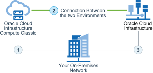

The following is a high-level diagram of the connections between your Oracle Cloud Infrastructure Compute Classic network (the source of your migration), the Oracle Cloud Infrastructure network (the target of your migration), and your on-premises data center network.
For information about the connection between your on-premises data center and your Oracle Cloud networks, see Connect Your On-Premises Network to Your Oracle Cloud Infrastructure Network. These connections are identified by items 1 and 3 in the diagram.

If the same IP address ranges have been retained in the Oracle Cloud Infrastructure network configuration that are used in the Oracle Cloud Infrastructure Compute Classic network configuration, then you should not connect both networks at the same time over IPSec or FastConnect as this will introduce routing conflicts, unless a NATing solution is place.
