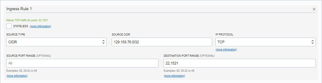

Ensure That Port 1521 Is Open Between the Primary Database and the Standby Database
You must ensure that the primary database (the source database) and the standby database (the target database) can connect to each other through port 1521.
