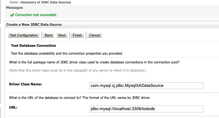

Add a data source configuration to access the database
Using the WebLogic Server Administration Console, log in and add a data source configuration to access the MySQL database. During the data source configuration, you can accept the default values for most fields, but the following fields are required to match the application and database settings you used when you created the MySQL database.
In the left pane in the Console, expand Services and select Data Sources.
On the Summary of JDBC Data Sources page, click New and select Generic Data Source.
On the JDBC Data Sources page, enter or select the following information:
- Name:
tododb - JNDI Name:
jdbc/ToDoDB - Database Type:
MySQL
- Name:
Click Next and then click Next two more times.
On the Create a New JDBC Data Source page, enter the following information:
- Database Name:
tododb - Host name:
localhost - Database Port:
3306 - Database User Name:
<your-mysql-username> - Password:
<your-mysql-password> - Confirm Password:
- Database Name:
Click Next.
Select Test Configuration, and make sure you see “Connection Test Succeeded” in the
Messagesfield of the Console.
Click Next.
On the Select Targets page, select
AdminServer. -
Click Finish to complete the configuration.

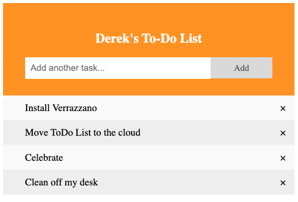

Access the application
- Access the application at
http://localhost:7001/todo/index.html.
- Add a few entries or delete some.
- After verifying the application and database, you may shut down the local WebLogic Server domain.

Update the application configuration
Update the generated vz-application.yaml file for the todo application to:
- Update the
tododomain-configmapcomponent to use the in-cluster MySQL service URLjdbc:mysql://mysql.tododomain.svc.cluster.local:3306/tododbto access the database.
wdt_jdbc.yaml: |
resources:
JDBCSystemResource:
'todo-ds':
JdbcResource:
JDBCDriverParams:
# This is the URL of the database used by the WebLogic Server application
URL: "jdbc:mysql://mysql.tododomain.svc.cluster.local:3306/tododb"

Access the application from your browser
Get the generated host name for the application.
$ kubectl get gateways.networking.istio.io tododomain-tododomain-appconf-gw \ -n tododomain \ -o jsonpath={.spec.servers[0].hosts[0]} # Sample output tododomain-appconf.tododomain.11.22.33.44.nip.io -
Initialize the database by accessing the
initURL.https://tododomain-appconf.tododomain.11.22.33.44.nip.io/todo/rest/items/init -
Access the application.
