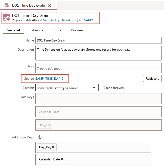

    Start by creating an alias. Each physical table should have at least one alias. Only the alias will be used and not the original table. This way if you need new instances of the same table for other roles in the future, it’s easy to identify the differences and roles of each alias.

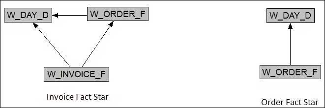

    This example shows three tables. Table W_ORDER_F is used as a fact table for order metrics, a dimension for order attributes, and it includes the Order Date. There is also calendar table W_DAY_D, and invoice table W_INVOICE_F that includes Order ID and Invoice Date. The invoice table is joined to the order table to retrieve order attributes as a dimension for Invoice Fact metrics. Note that Oracle Analytics generates separate sub-queries for each fact table. Therefore, we must consider Order Fact Star and Invoice Fact Star separately, as shown in the diagram.
    Without any aliases, the diagrams look like this:
    Description of ceal-table-alias-example2.jpg follows
    This configuration causes similar data integrity issues to the Employee example, that is, the Order Date isn't equal to Invoice Date but they're both joined to the same date column on the calendar table.

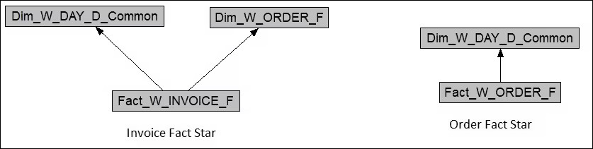

    The solution is to create two aliases for the Order table: one alias for the fact and the second alias for the dimension. With aliases the diagrams look like this:

    Now there's no conflict between the joins, as the dimension alias of the Order table isn't joined to the calendar dimension.
    Also note that there’s no need to join Fact_W_ORDER_F with Dim_W_ORDER_D. Except for rare specific situations, you should never join two aliases of the same table together. While doing so doesn’t impact data integrity, it's useless and impacts performance.
    Instead, create two logical table sources in the Order Dimension in the business model. Use one logical table source for the Invoice Fact Star and the other for the Order Fact Star.
