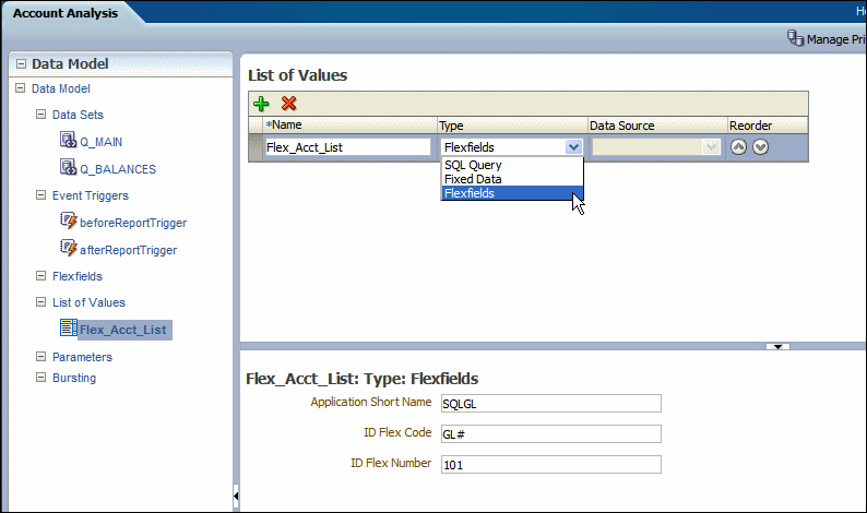

  1. On the Data Model components pane, click List of Values and then click Create new List of Values.
  2. Enter a Name for the list and choose Flexfields as the Type.
  3. In the Flex_Acct_List: Type: Flexfields pane, enter the following:
    • Application Short Name - E-Business Suite application short name, for example: SQLGL.
    • ID Flex Code - Flexfield code defined for this flexfield in the Register Key Flexfield form, for example: GL#.
    • ID Flex Number - Name of the source column or parameter that contains the flexfield structure information, for example: 101 or :STRUCT_NUM. If you use a parameter, ensure that you define the parameter in the data model.
    The image shows a sample flexfield type, LOV.

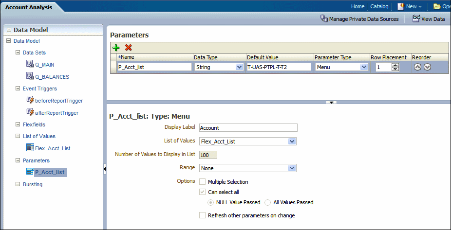

  1. On the Data Model components pane, click Parameters and then click Create new Parameter.
  2. Select Menu from the Parameter Type list.
  3. Choose String or Integer as the Data Type.
  4. Enter a Default Value for the flexfield parameter.
  5. Enter the Row Placement.
  6. Enter the Display Label. The display label is the label that displays to users when they view the report. For example: Account From.
  7. Select the List of Values that you defined for this parameter.
    When you select a list of values that is the Flexfield type, an additional field labeled Range displays.
The image shows a parameter definition for the flexfield list of values.

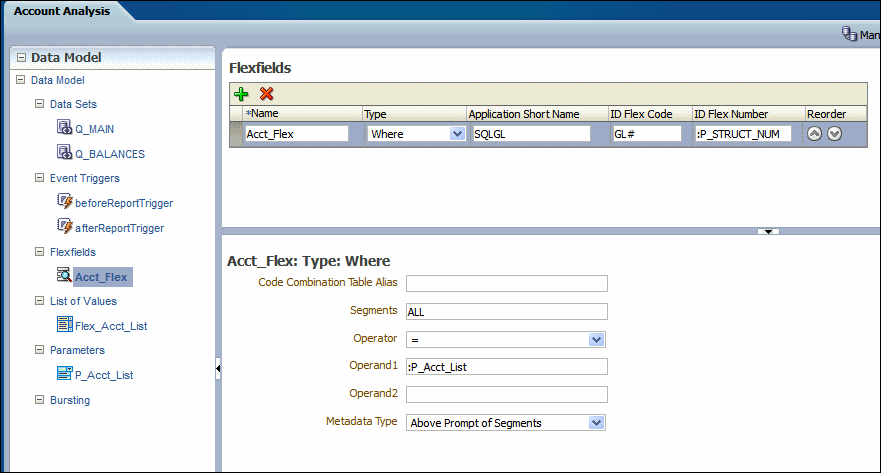

  3. In the lower region of the page, enter the details for the type of flexfield you selected. For the field that is to take the parameter value, enter the parameter name prefixed with a colon, for example, :P_Acct_List.
    In the figure below the Flexfield component is defined as a "Where" Type. The parameter :P_Acct_List is entered in the Operand1 field. At runtime, values selected by the user for the parameter P_Acct_List will be used to create the where clause.

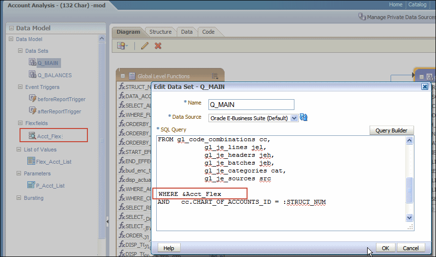

Reference the Flexfield in the SQL Query
Finally, create the SQL query against the E-Business Suite database.
Use the lexical syntax in the SQL query. In the figure below &Acct_Flex is the Flexfield lexical called in the where condition of the SQL query.

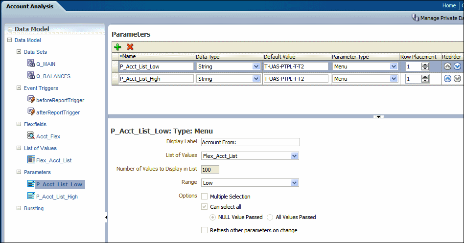

To define the parameters for the flexfield lists of values when you want to pass a range of values you create two menu parameters that both reference the same flexfield LOV.
At runtime users choose a high value from the list of values and a low value from the same list of values. These two values are then passed as operands to the flexfield component of the data model.
  1. Create one flexfield LOV.
  2. Create the high range parameter. For the Range field, select High to designate this parameter as the high value.
  3. Create the low range parameter. For the Range field, select Low to designate this parameter as the low value. Both parameters reference the flexfield list of values that you created in Step 1. The figure below shows creating the parameters to define the range.

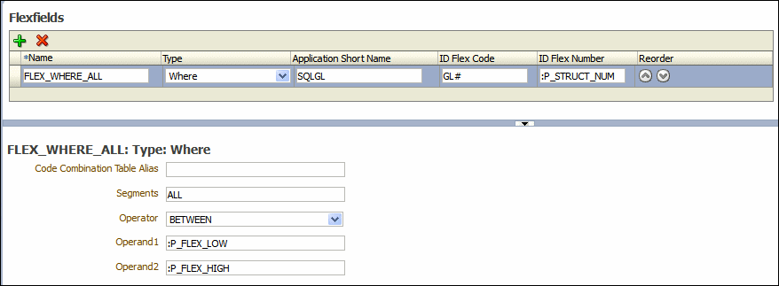

  4. Create the Flexfield in the data model.
    In the lower region of the page, enter the details for the type of flexfield you selected. Enter the parameter prefixed with a colon for example, :P_Acct_List.
    In the figure below the Flexfield component is defined as a "Where" Type. The parameters :P_FLEX_LOW and :P_FLEX_HIGH are entered in the Operand1 and Operand2 fields. At runtime, values selected by the user for the parameters P_FLEX_LOW and P_FLEX_HIGH will be used to create the where clause.

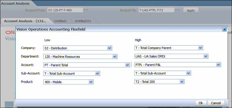

When the report associated with this data model is displayed in the report viewer, the report consumer sees the two flexfield parameters as shown below.
When the report consumer clicks either the high or low flexfield indicator (...), a dialog launches enabling input of both the high and low values as shown below.
The display characteristics in the report viewer of the range flexfield parameter resemble closely the presentation of range flexfields in the E-Business Suite.
