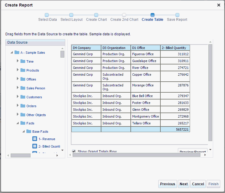

Table Layout
On the Create Table page you add columns to the layout by dragging and dropping them from the Data Source pane to the table area.
The columns are displayed in a simple tabular format and the column widths are automatically adjusted based on the number of selected columns as shown in the following illustration.
To remove a column from the table, hover your mouse over the upper-right hand corner of the column header and click Delete.
The Show Grand Totals Row option is selected by default to automatically display an aggregated summary row for all columns. Deselect this option to remove the row from the table.
Click Preview Report to display the report in the report viewer.
Click Next to proceed to save the report.

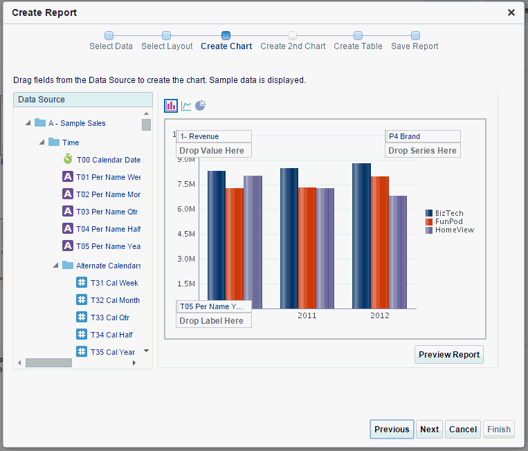

Chart Layout
The Chart Layout page supports three types of charts. Choose the chart type by clicking its icon: Bar, Line, or Pie. Add columns to the chart by dragging and dropping them from the Data Source pane to the chart area.
The following figure shows the create chart layout. You can specify two values each to display for the chart Value, Series, and Label.
The layout editor supports a variety of more complex charts. To add more values to this chart or create another chart type, edit this layout in the layout editor after saving the report.
To remove a value from the chart, hover your mouse over the upper-right hand corner of the item label and click Delete.

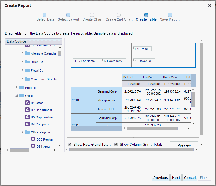

Pivot Table Layout
When you select columns for the pivot table layout, the columns display on the Create Table page.
The figure below shows the columns displayed.
The Show Row Grand Totals option is selected by default. Deselect this option to hide the row in the table that includes the grand total for each column.
The Show Column Grand Totals option is selected by default. Deselect this option to hide the column in the table that includes the grand total for each row.
Click Switch Rows and Columns to flip the rows and columns axes.

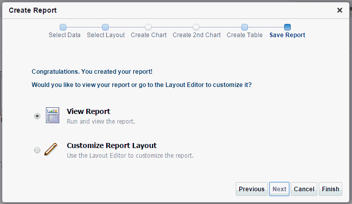

Save the Report
You can save the report layout and the columns you added.
Use the Save Report page as shown in the following illustration.
Select one of the following options:
To run the report you just created, click View Report and then click Finish. The final page prompts you to save the report. After saving, Publisher runs and displays the report in the report viewer.
To customize the report layout, click Customize Report Layout and then click Finish. The final page prompts you to save the report. After saving, the report opens in the layout editor.
