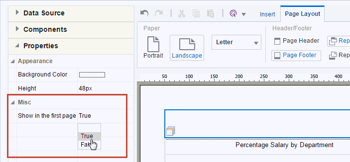

Set Properties for Headers and Footers
The Properties pane enables you to set the following properties for headers and footers.
To access the Properties pane, select the header or footer in the design region, then click Properties from the accordion pane on the left of the page.
For all report and page headers and footers:
Height - Set the height of the header region in pixels, points, centimeters, or inches
For headers:
Show in the first page - Select True to show the header in the first page. Select False to suppress the header from the first page.
This figure shows the Properties for a report header.
For footers:
Show in the last page - Select True to show the footer in the last page. Select False to suppress the footer from the last page.

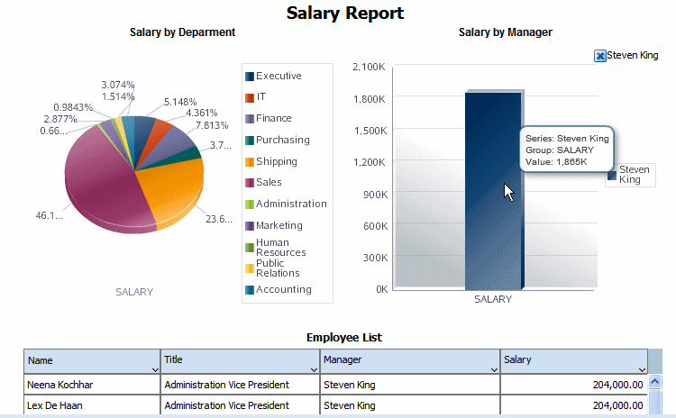

Example of Filter Event Configuration
The illustration here shows an example of filter event configuration. The layout contains two charts and a table. The first chart shows salary totals by department in a pie chart. The second chart shows salary totals by manager in a bar chart. The table displays a list of employees and their salaries.
In this report, if a user clicks on a value in the Salary by Department chart, you want the Salary by Manager chart and the Employees table to automatically filter to show only the managers and employees in the selected department.

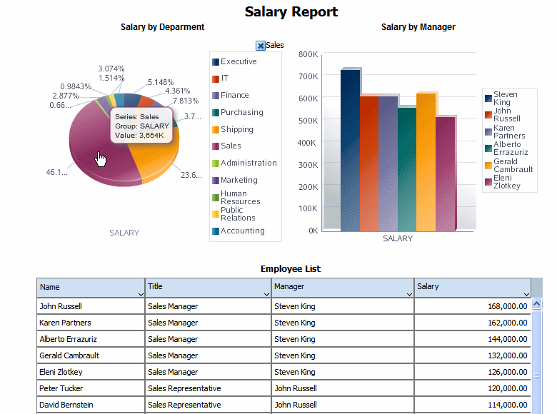

Example: Show Selection Only
The Show Selection Only event displays only the value of the selected element within the chart or pivot table (being acted on).
In the example shown in the following figure, Chart 2 is configured with Show Selection Only enabled and Filter enabled with Table 3 as the Target.
This configuration results in the output shown in the following figure. When the user clicks on Chart 2, only the selected value is shown in Chart 2. Because the Filter event is enabled for Table 3, the selection is applied as a filter to Table 3.

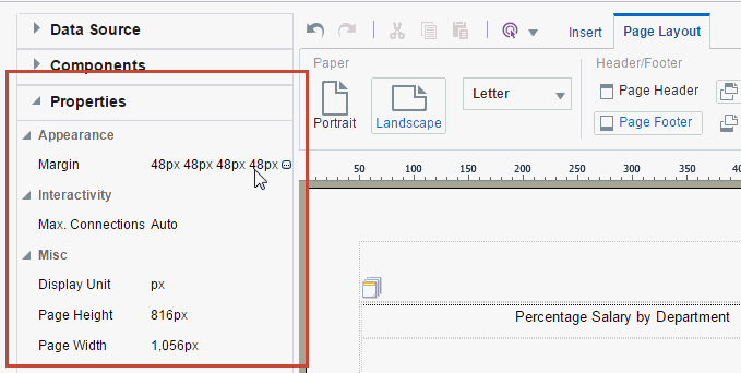

Set Maximum Connections for an Interactive Report
You can limit the connections from the browser to the server for the interactive viewer.
More connections are faster but increase server load. The default is six connections. Reduce the number to reduce the load on the server for large reports.
To set the maximum connections for this layout:
