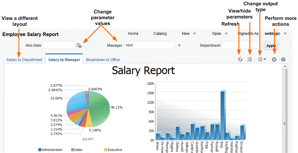

Use the illustrated Report Viewer to configure pixel-perfect reports.
The following options are available in Report Viewer. Not all options are available for all reports.
  • Specify parameters
  • Select layout
  • Select output type
  • Perform actions
The image shows the Report Viewer options.
