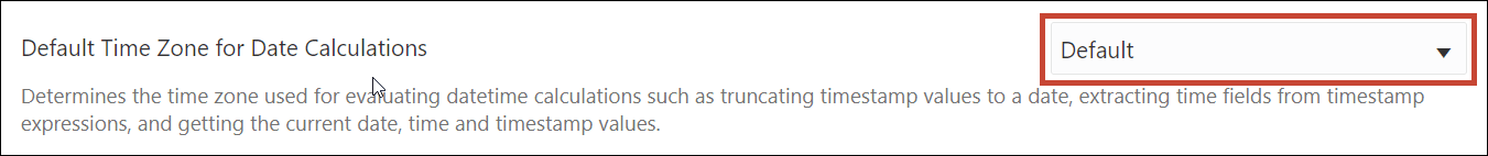

As an administrator, you can change the timestamp used in calculations using the Default Time Zone for Date Calculations option in the Console, under Advanced System Settings. Select the desired time zone from the drop-down list and apply the changes for the new value to take effect.
