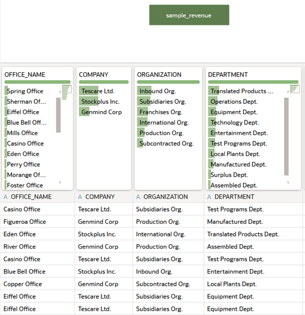

Create a Dataset
- Sign in to Oracle Analytics.
- On the Home page, click Create, and then click Dataset.
- In Create Dataset, click Drop data file here or click to browse, select the
sample_revenue.xlsxfile, and then click Open. - In Create Dataset from sample_revenue.xlsx, click OK.
- Click Save
. In Save Dataset As, enter sample_revenue, and then click OK.

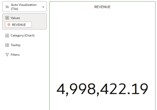

In this section, you select revenue, an aggregated (measure) data element, and let Oracle Analytics generate the best data visualization, a performance tile. You add a time-series attribute to the performance tile to create a spark chart.
- Click Create Workbook.
- From the Data panel, select and drag Revenue to the canvas.

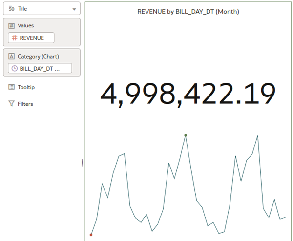

Description of the illustration rev_tile.png - In the Data panel, expand BILL_DAY_DT, and then drag Month to Category (Chart).
The red dot on the spark chart line shows the lowest value, and the green dot shows the highest value.

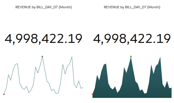

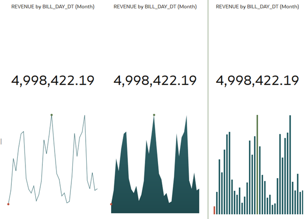

Change the Spark Chart Type
- In the visualization, click Menu
, select Edit, and then select Duplicate Visualization. - In the new visualization's Properties, click Line in the Chart row, and then select Area.
Description of the illustration area_spark_chart.png - In the visualization, click Menu
, click Area in the Chart row, and then select Bar.
Description of the illustration 3_spark_charts.png - Click the area spark chart visualization, click Menu
, and then select Delete Visualization. - Click the bar spark chart visualization, click Menu

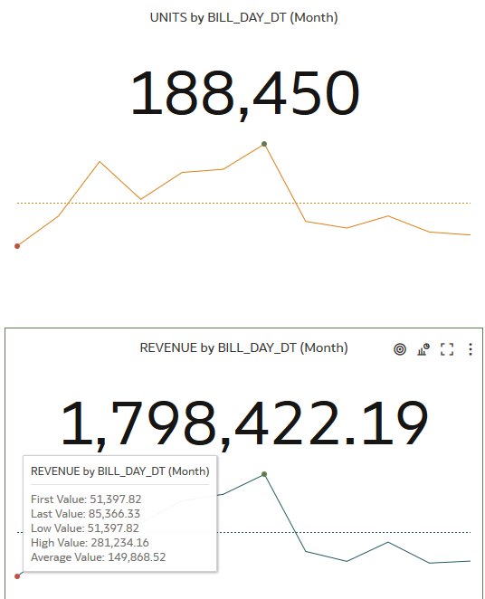

The filter changes the spark lines to show the high and low values for both revenue and the number of units. The tooltip shows the average number of units is 15,704 during 2010.

Add an Average Reference Line
- Select the UNITS by BILL_DAY_DT (Month) visualization. In UNITS by BILL_DAY_DT (Month) Properties, click None in the Reference Line row, and then select Average.
- Select the REVENUE by BILL_DAY_DT (Month) visualization. In REVENUE by BILL_DAY_DT (Month) Properties, click None in the Reference Line row, and then select Average.
