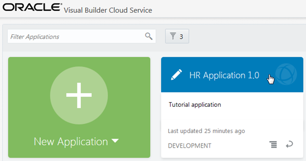

  1. Log in to Oracle Visual Builder Cloud Service if you are not already logged in.
  2. On the Home page, click HR Application 1.0.

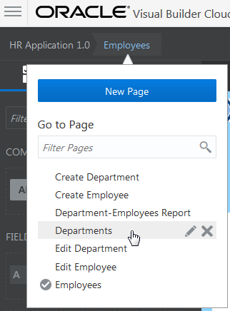

  3. In the Page Designer, open the page menu and select Departments.

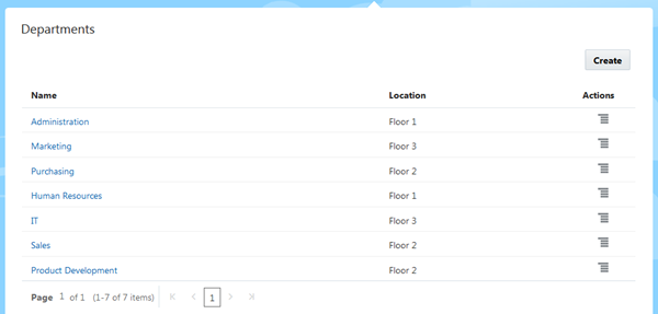

  5. On the Departments page, click Create.
    Departments page in Test Application mode

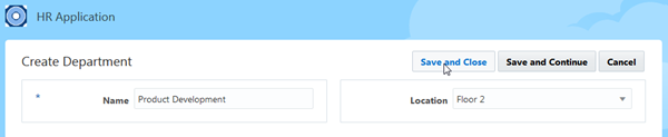

  6. On the Create Department page, enter Product Development in the Name field, and select Floor 2 from the Location drop-down list. Finally, click Save and Close.
    Create Department page in Test Application mode
    A success message appears, and the new department appears at the end of the Departments table.

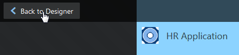

  7. Click Back to Designer to return to the Page Designer.
    Back to Designer button

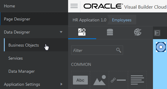

  2. Click Main Menu Main Menu, expand Data Designer, and select Business Objects.

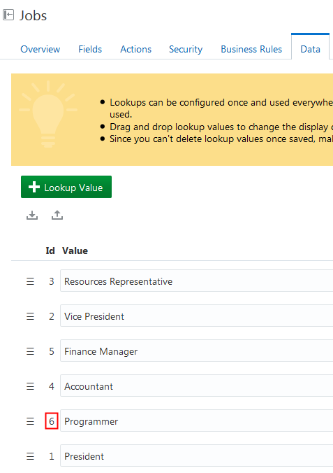

  3. Click Jobs, then click the Data tab.
    Jobs business object in Data Designer
  4. In the Data tab, notice that the Id value for the Programmer job is 6. Make a note of this value.
    Data tab for Jobs business object

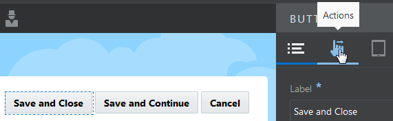

  2. Click the Save and Close button, then click the Actions tab in the Button Property Inspector.
    Button Actions tab

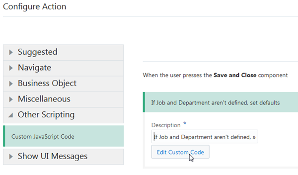

  4. Expand Other Scripting in the left column, then drag Custom JavaScript Code above the Save Employee action.
    Custom JavaScript Code action
  5. In the Description text field, enter a description of the action you'll define, such as If Job and Department aren't defined, set defaults, then click Edit Custom Code.

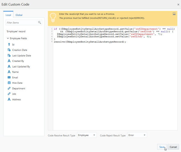

  6. In the Edit Custom Code dialog box, expand the Employee Fields node and click Department. A getValue call for the Department reference appears in the code window.
  7. Add a space after the getValue call and then click Job to get another getValue call. Then add code to perform the logic you need. The final code looks like this. (You can just paste the following code into the text area to avoid mistakes.)
    if (($EmployeeEntityDetailArchetypeRecord.getValue('ref2Department') == null)
        && ($EmployeeEntityDetailArchetypeRecord.getValue('ref2Job') == null)) {
      $EmployeeEntityDetailArchetypeRecord.setValue('ref2Department', 7);
      $EmployeeEntityDetailArchetypeRecord.setValue('ref2Job', 6);
    resolve($EmployeeEntityDetailArchetypeRecord);
    If both the Department and Job fields are empty, call setValue to set the Department to the correct Id value for Product Development (7), and call the same method to set the Job to the correct Id value for Programmer (6). Make sure that you finish with a call to resolve to fulfill a promise.
  8. At the bottom, select Employee from the Code Resolve Result Type drop-down list, then click Save to return to the Configure Actions dialog box.

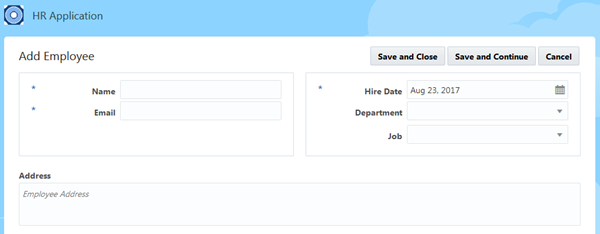

  1. To verify that your button modification works correctly, click the Test Application Test Application button in the toolbar. Since you were on the Create Employee page in the Page Designer, you are on that page when you test the application.

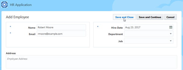

  2. Enter values in the Name and Email fields, but leave the Department and Job fields blank. (If you like, enter a value in the Address field or change the Hire Date.) Finally, click Save and Close.
    A success message appears briefly ("Employee 10 has been created"). The Employees page opens, and the employee you added is at the end of the list, in the Product Development department, and with the job of Programmer.
