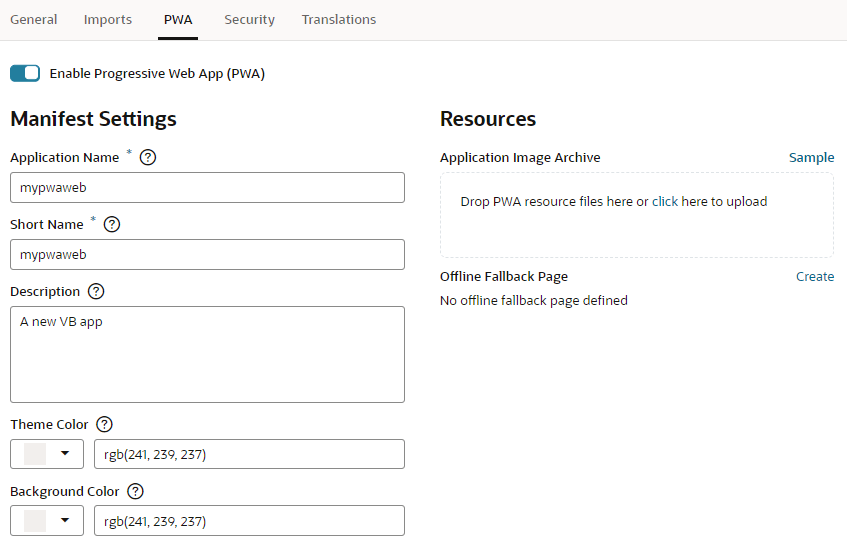

You can enable and configure Progressive Web App (PWA) support for both web and mobile applications from your app's Settings page.
Mobile apps have been deprecated starting with version 23.10. You can no longer create a mobile app, but you can import an existing mobile app and deploy it as a PWA to be able to use it. You can use your PWA-enabled mobile apps until July 2024 when mobile apps reach End of Life (EOL). To use your mobile-enabled PWAs beyond July 2024, we strongly urge you to transition your mobile app as a web app and deploy it as a PWA.When you enable an application for PWA, Visual Builder adds the necessary files to your project such as a web manifest file (a JSON configuration file) as well as required icons and splash screens. The web manifest stores configuration settings required by the PWA. You can modify these settings from the Manifest Settings section of the PWA page. For more information on this file, see this page.

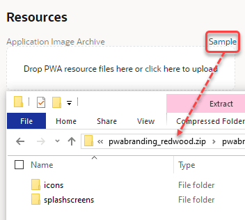

Oracle provides Redwood-themed icons and splash screens for your app. You can replace these images with your own branded versions if desired. For PWAs that run on Android 8.0 and higher devices, you can also use adaptive icons that display as a variety of shapes on different device models.
