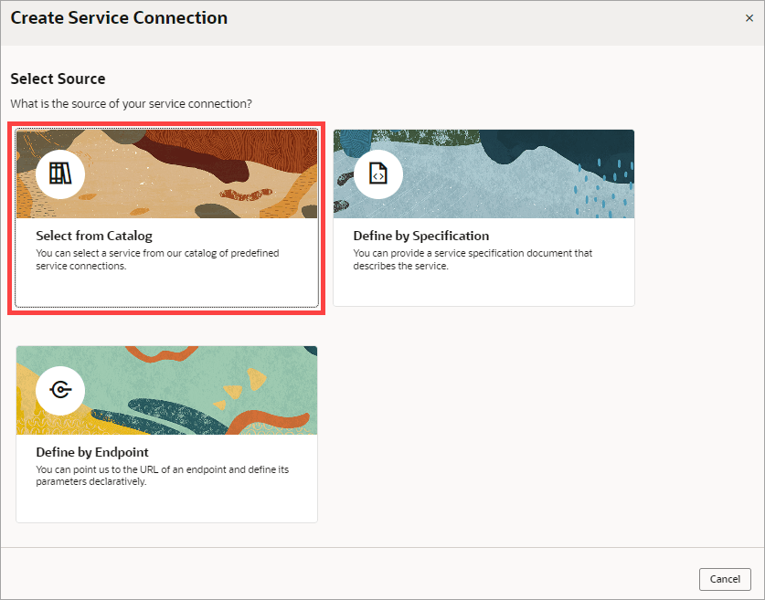

Create a Service Connection from a Catalog
A catalog provides a list of services and their endpoints from an Oracle cloud service backend or a custom backend. Using a catalog to create a service connection saves you time, as common configuration tasks like authentication, connection type, and headers are predefined for you.
Description of select-from-catalog1.png follows
