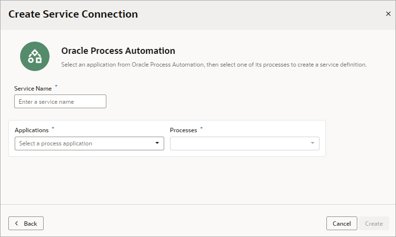

  3. Click Select from Catalog in the Select Source step of the Create Service Connection wizard:
  4. Select the OCI Process Automation catalog.
  5. Enter these details for the OCI Process Automation service:
    1. Service Name: Enter a name for the service.
    2. Applications: Select the Process Application with the OCI Process Automation process you want to use.
    3. Processes: Select the OCI Process Automation process, in the process application, to which you want to connect.
  6. Click Create.
Your new OCI Process Automation service is added to the Service Connections tab of the Services pane. Its details are shown on the right for you to further configure the connection. Here's what you may see on the connection's Settings tab:
