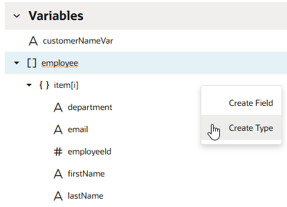

    Tip:
    You can quickly create a new type based on the structure of a variable, if the variable uses array or object as its type. Simply right-click the variable and select Create Type. This way, you can readily create a type based on a variable's existing structure and assign the variable (as well as other new ones) to that type.
    Conversely, to quickly create variables for a custom type, switch to the Types editor, select your type, right-click, and select Create Variable.
