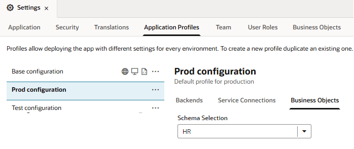

    It's possible to map a profile to a schema in the Application Profiles page by selecting the profile you want to manage, then using the profile's Business Objects tab to associate a schema, as shown here:
    Description of byos-settings-app-profile-schema2.png follows

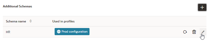

    But the Business Objects tab on the Settings editor provides a more visual way to map schemas to profiles, as described here:
    1. Click Menu in the upper right corner and select Settings (if necessary), then click Business Objects.
    2. Under Schema Selection, with your schema already selected, click Add Schema next to Additional Schemas.
    3. Select an available schema (for example, HR), then from the Used in profiles list, select the profile you want to associate the schema with. You can add more than one profile if you want.
    4. Click Add.
      The schema (mapped to the profile) appears under Additional Schemas. If you want to update the profile, click Edit icon in the schema's row and make changes in the Used in profiles column. You can change the selected profile as well as add other profiles.
      Description of byos-settings-edit-addl-schema1.png follows
