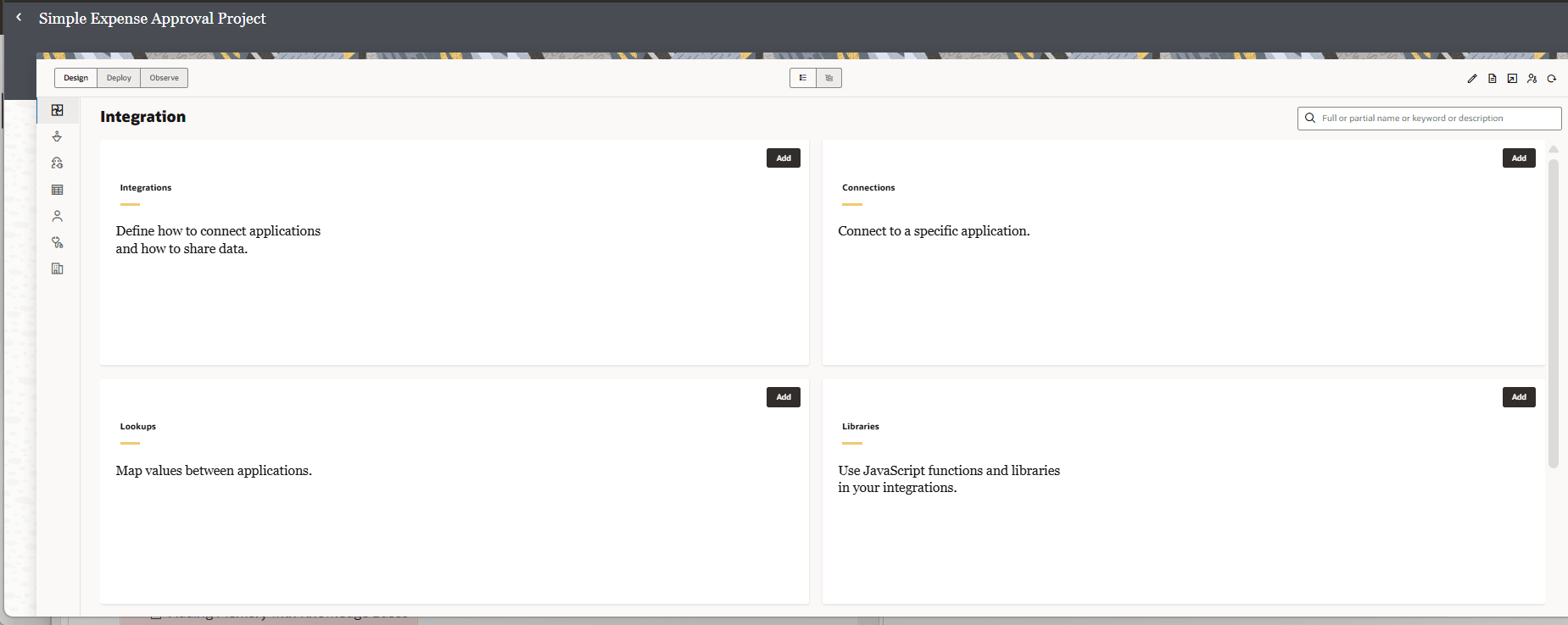

  5. In Name:, specify Simple Expense Approval Project and click Create.
    The project detail page is displayed.
    The page for a specific project shows the navigation pane on the left with the following icons from top to bottom: Integration, AI Agent, Robot, Decision, Human in the loop, Healthcare, B2B. In the upper right are the icons: Edit, Learn about this project, Export, Share, Refresh. Below is a Search field. In the Integration area, there are four boxes: Integrations, Connections, Lookups, Libraries. An Add button appears in each box.
