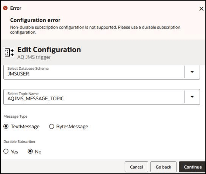

Configuration Error: Non-durable subscription configuration is not supported
You encounter the following error if you configured your subscriber as non-durable.
Solution: A simple resolution is to select Yes for the Durable Subscriber option on the Trigger Dequeue Configurations page. The Oracle Advanced Queuing (AQ) JMS Adapter no longer supports nondurable subscribers even though the option is visible on the Adapter Endpoint Configuration Wizard page. This issue is currently being addressed.
