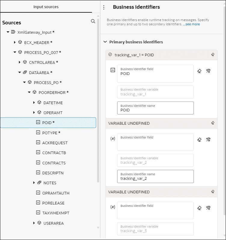

In the "PROCESS PO" integration canvas, click Business Identifiers
The Business identifiers panel appears.
From the Sources section, expand the XmlGateway_Input node, then the PROCESS_PO_007 node, then the DATAAREA node, then the PROCESS_PO node, and then the POORDERHDR node.
Drag and drop the POID element to the Primary business identifiers as the primary key. A checkmark to the left of the POID element indicates that this is the primary business identifier.
Save your work.
