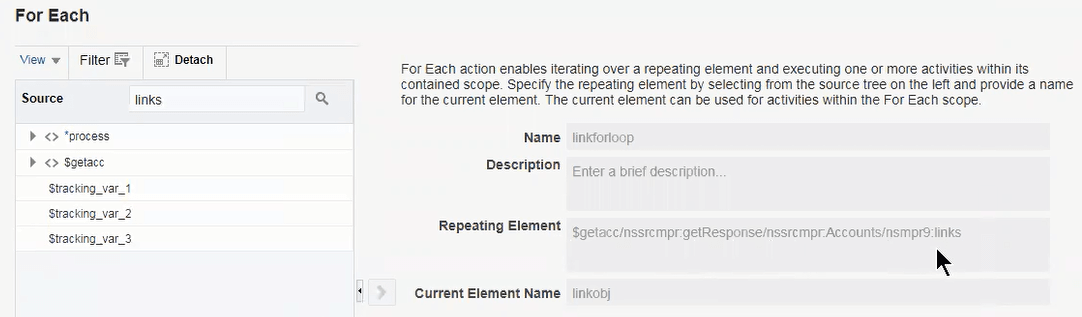

  7. Add a for-each action to iterate between the HATEOS links. The value in the Repeating Element field is from the response object.
