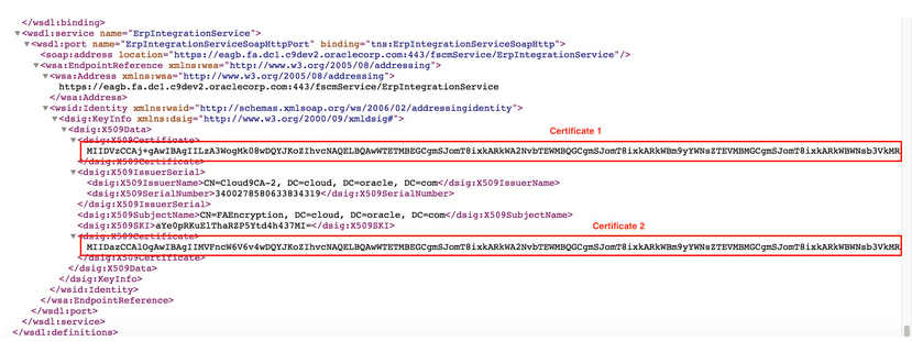

      • In the WSDL, navigate to the X509 certificates section:
        Description of erp-certificates.png follows
      • Copy the first certificate string to a file.
        For each certificate file that you create, add your certificate string between the -----BEGIN CERTIFICATE----- and -----END CERTIFICATE----- lines for the certificate to be successfully imported into Oracle Integration. For example:
        certificate_string
        Otherwise, you may receive an Invalid Certificate error.
      • Copy the second certificate to a file. You have two certificate files (for example, erp_cert1.cer and erp_cert2.cer).
      • In the Upload Certificate dialog in Oracle Integration, import both certificates as Message Protection Certificate types and enter unique alias names. See Upload a Certificate to Connect with External Services.
