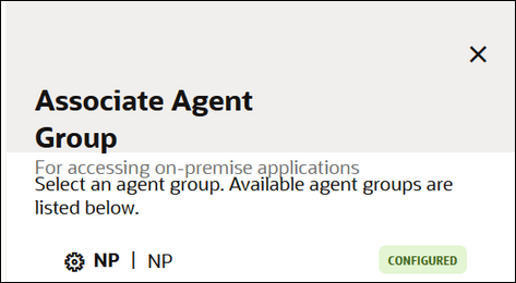

Configure Agent Group
 If the FTP server is not directly accessible from Oracle Integration
                (for example, the server is installed on-premises or behind a firewall), you must
                configure the connectivity agent for this connection. This can be done in the
                    Associate Agent Group section.
