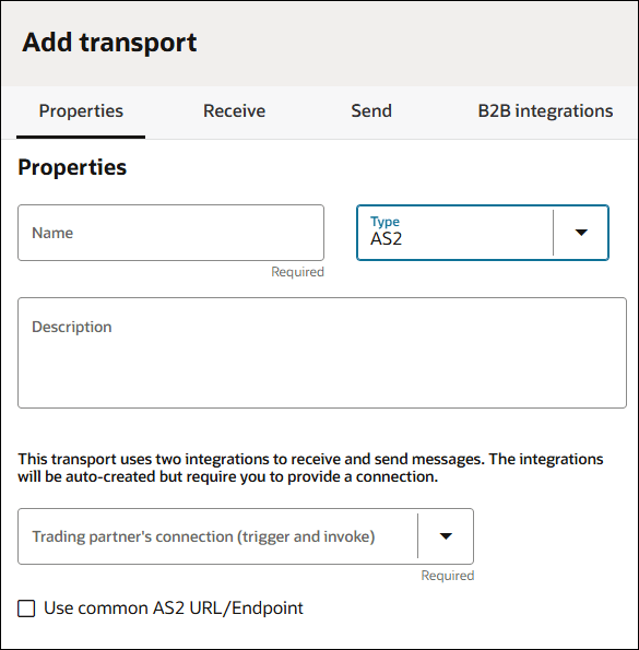

  1. In the Transports section, click Add Install icon to define how a message is delivered to or received from this trading partner. The configuration panel is opened:
    The Add transport dialog shows tabs for Properties, Receive, Send, and B2B Integrations. Below are the Name, Type, and Description fields. The Cancel and Add buttons are in the lower right.
  2. In the Add transport dialog, enter the details for the following sections.
