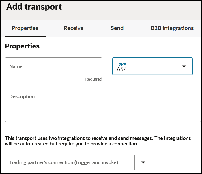

Define Transports to Create Integrations
  1. In the Transports section, click Add Install icon to define how a message is delivered to or received from this trading partner. The configuration panel is opened:
    The Add Transport page shows tabs for Properties, Receive, Send, and B2B Integrations. Below are the Name, Type, and Description fields. The Cancel and Add buttons are in the lower right.
  2. Define the following details.
    Section Description
    Properties section
    • Name
    Enter a name for the transport. The name is used for display purposes only.
    • Type
    Select AS4 from the drop-down. This represents the communication protocol you use to exchange messages with your trading partner.
    Based on selecting AS4, the appropriate configuration settings for the AS4 transport are displayed.
    • Description
    Enter an optional description of the transport. The description is used for display purposes only.
    • Trading partner's connection (trigger and invoke)
    Select an existing AS4 Adapter connection configured for connectivity to your trading partner. If you are outside of a project, you can click Add Install icon to create a new AS4 Adapter connection on the Connections page. It must be a Trigger and invoke connection. Invoke Only connections cannot be used for transports.
    See Create a Connection in Using the AS4 Adapter with Oracle Integration 3.
    If you want to select another connection, you can do so when this transport is not deployed. Once you deploy the transport, the connection selection cannot be changed.
    You can modify the configuration properties inside the connection at any time. However, if you modify the connection settings after this transport is deployed, you must undeploy and then redeploy the transport for the changes to take effect.
