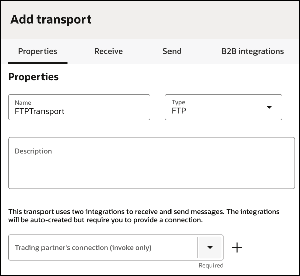

  4. In the Transports section, click Add Install icon to define how a message is delivered to or received from this trading partner. The configuration panel is opened:
    The Add Transport page shows tabs for Properties, Receive, Send, and B2B integrations. Below are the Name, Type, Description and connection fields.
  5. Define the following details.

    Properties section
    • Name
    Enter a name for the transport.
    The name is used for display purposes only.
    • Type
    Select FTP from the drop-down list.
    This represents the communication protocol you use to exchange messages with your trading partner. Based on selecting FTP, the appropriate configuration settings for the FTP transport are displayed.
    • Description
    Enter a description of the transport.
    The description is used for display purposes only.
    • Trading partner's connection (invoke only)
    Select an existing FTP Adapter connection to use. If you are outside of a project, you can click Add Install icon to create a new FTP Adapter connection on the Connections page. Use an Invoke only connection.
    Note that the Trading partner's connection drop-down only displays the Invoke only FTP connection. Trigger and invoke and Trigger only connections are not supported for FTP transports.
    See Create a Connection in Using the FTP Adapter with Oracle Integration 3.
    If you want to select another connection, you can do so when this transport is not deployed. Once you deploy the transport, the connection selection cannot be changed.
    You can modify the configuration properties inside the connection at any time. However, if you modify the connection settings after this transport is deployed, you must undeploy and then redeploy the transport for the changes to take effect.
