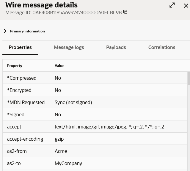

  2. View details of wire messages.
    Click View details View details icon on a message to open the Wire message details panel.
    A table with columns for Status and Transport Message appears on the left side. The status of Successful is selected. To the right, the Wire Message Details dialog shows a Close button in the upper right. Below is the message ID number. Below is the Primary Information section with tabs for Properties, Message Logs, Payloads, and Correlations. Below this is the Execution Details section.
    The panel contains the following tabs:
    • Properties: Shows header properties and values (for example, HTTP and MIME).

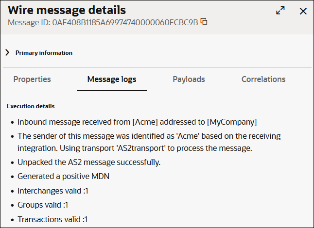

    • Message logs (displayed by default): The message log is similar to the activity stream available for integrations. It provides details such as the following:
      • The message sent from the trading partner to the host trading partner (for an inbound message). The trading partner names shown are based on the headers that you mapped to the B2B identifiers defined in the agreement. See Create Trading Partners.
      • The identity of the trading partner that sent the message.
      • The unpacking of the message (preprocessing tasks such as message decryption, signature verification, and others).
      • The status of the MDN acknowledgment message sent to the trading partner.
      • Additional post-processing tasks.
      This image shows Wire message details. The message ID appears at the top. Below is the Primary information section. Below this are tabs for Properties, Message logs (which is selected), Payloads, and Correlations. Below this is the Execution details section.
