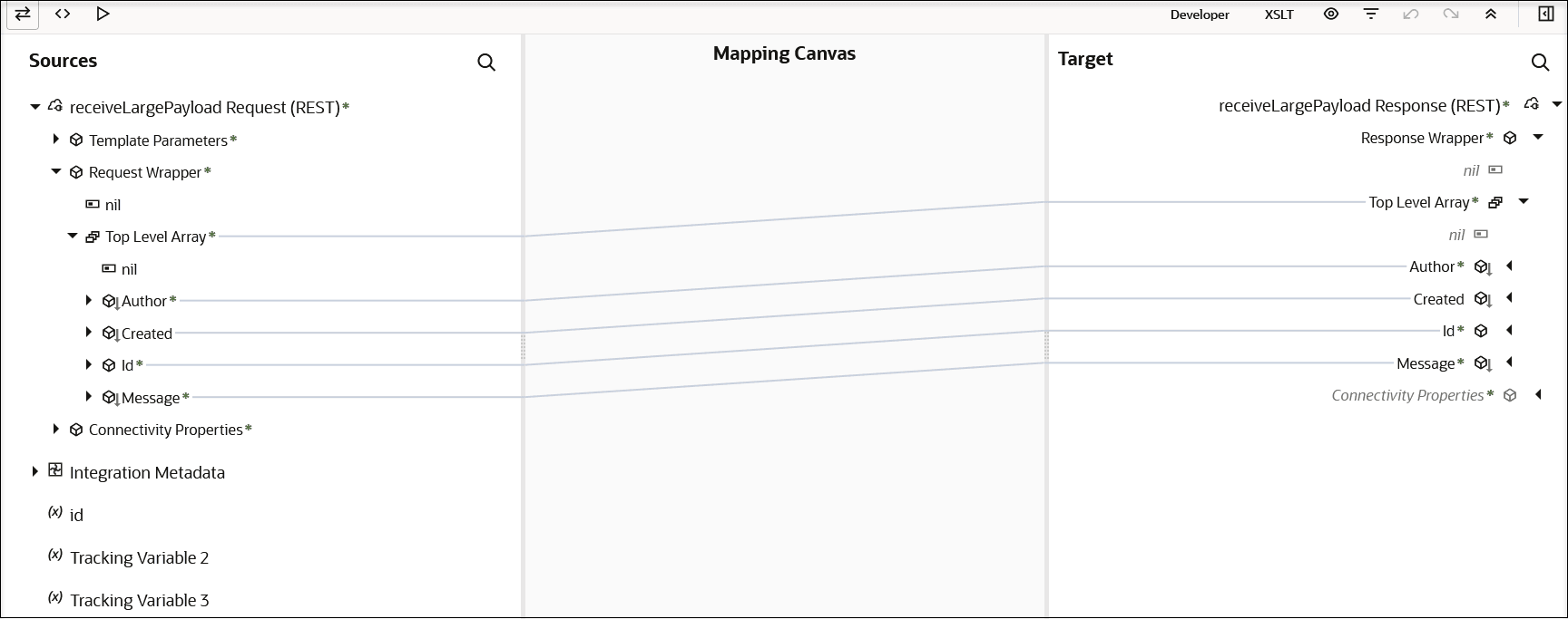

In most cases, the messages you want to transfer between the applications in an integration have different data structures. A visual mapper enables you to map element nodes between applications by dragging source element nodes onto target element nodes. When you open the mapper for a request or response message in an integration, the data structures are automatically populated with the information pulled from the source and target connections. You can expand and load data structure levels on demand to display additional levels. There is no limit on the levels of display.

Elements and attributes for which mapping is required are identified by a blue asterisk (*) to the left of their names. To display only required fields, click the Filter Filter icon icon in the mapper toolbar, select Required Fields, and click Apply.
You can also right-click elements and attributes and select Node Info to show specific schema details such as the data type, if mapping is required, and so on.
