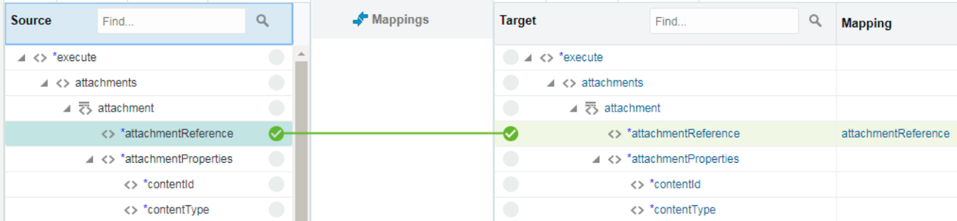

  • Both source and target have multipart requests with JSON/XML payload (category A)
    The following sample map focuses only on the mapping of attachmentReference to the target. In this scenario, there is an assumption that only one attachment from the source is being mapped to the target. The mapping of the payload (request-wrapper node) between the source and target is not shown. You must perform that task.
    Description of rest-multipart-1.png follows

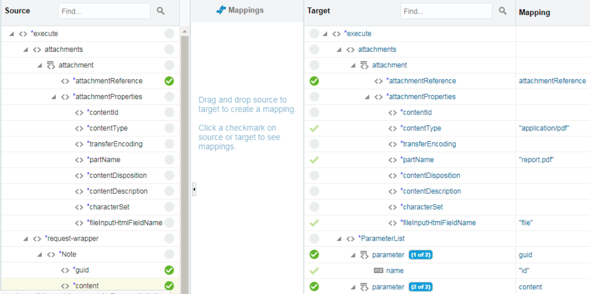

  • The source is multipart/mixed or multipart/form-data with JSON/XML payload (Category A). The target is multipart/form-data with form fields (Category B)
    The following map focuses on mapping of the attributes on the HTML form. There must be as many parameters in the parameterList as there are fields in the HTML form.
    Description of rest-multipart-2.png follows

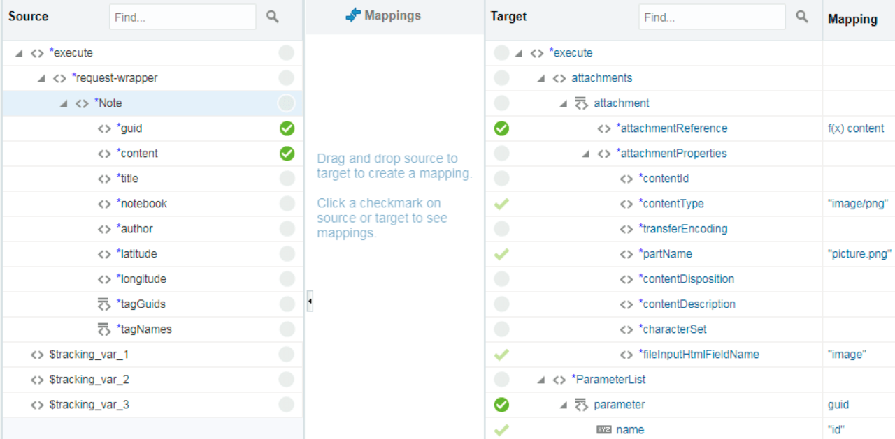

  • Creating a reference from base64–encoded content. The source has a base64–encoded string and the target can be any of the three: multipart/mixed, multipart/form-data with JSON/XML payload, or multipart/form-data with HTML form payload.
    In the inbound payload, the content element is a base64–encoded string. This can be sent as an attachment in the outbound request.
    Since the inbound request is not multipart, but the outbound must be multipart, you must set multipart-specific properties in the mapper for the outbound direction. The contentType is set here to image/png, partName is set to picture.png, and fileInputHtmlFieldName is set to image. The assumption is that the target system is configured to read from a body part having name="image" in its content disposition. This is done with the element fileInputHtmlFieldName.
    Description of rest-multipart-3.png follows

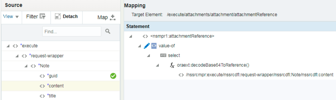

    The base64 string can be converted into a reference using XSL function decodeBase64ToReference and the reference can be assigned to the attachmentReference element.
    Description of rest-multipart-4.png follows

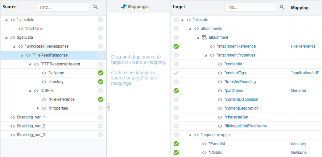

  • The inbound is an FTP file read operation (nonmultipart) and the outbound is multipart/mixed with a JSON or XML payload.
    Description of rest-multipart-5.png follows
  • If the source is not multipart, but the target must be multipart, contentType and partName must be provided for the target through the mapper.
