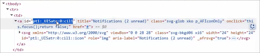

In the application for which you're building a robot, right-click the element you're trying to target, and select Inspect.
The DevTools appear.
On the Elements tab, find the element that wraps the
svgorimgtag. This element containsa id=. For example:
Copy the value that appears within the quotation marks for
id=" ". -

Update the Locator value. For instance, paste the value that you copied between the quotation marks in the
@id=" "value.In the Locator field, if any additional text appears after the closing bracket
], remove the extra text. For example, the value should be something like this:xpath://*[@id="pt1:_UISatr:0:cil1"] -
